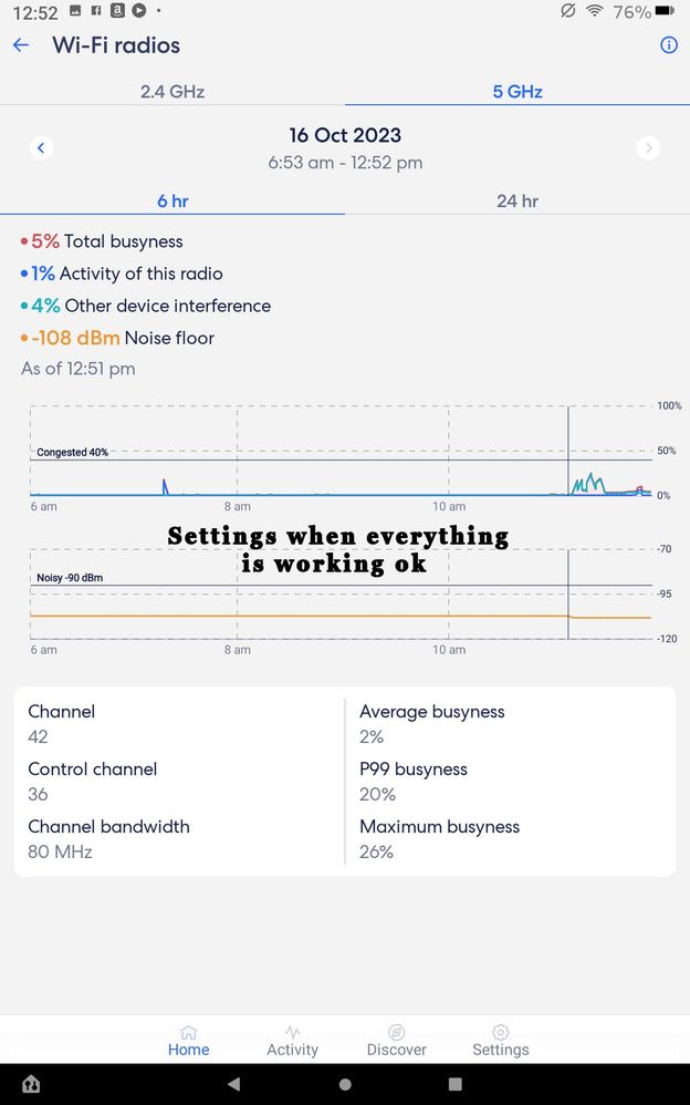

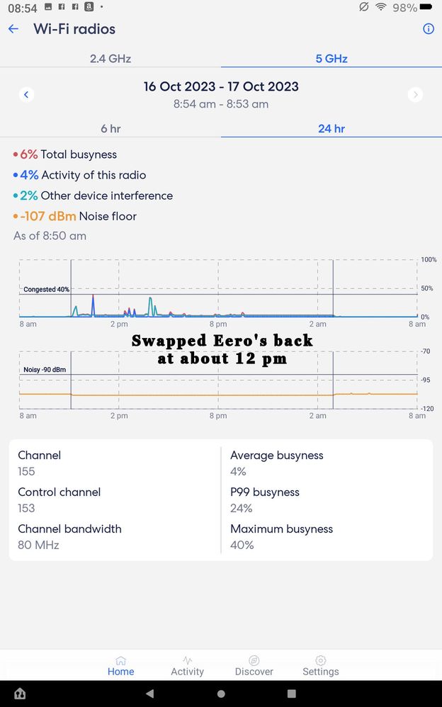

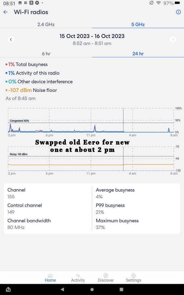

Unfortunately the next morning all my devices were back on 2.4GHz and
running slow speeds. Looking at the Wi-Fi radios page in the app it is clear
to see the 5GHz channel and control channel changed at about 03.00 am.
When devices do connect to 5GHz the Wi-Fi radios page in the app shows :
channel 42
control channel 36
when devices will not detect 5GHz Wi-Fi radios page in the app shows :
channel 155
control channel 149/153
Tried unplugging for 30 mins, soft restart etc but nothing would bring back the
5GHz signal. I then tried swapping Eero's again and everything worked fine again until
about 03.00 am when the channel and control channel changed again. Why would
it do this? and why at the same time every day?
I have sent three screenshots to show this.
