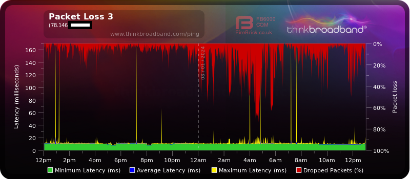

Yet i have constant packet loss, this has been ongoing since around late october, november the 7th was when it was first reported it, and i have been on live chat countless times since trying to get a resolution.

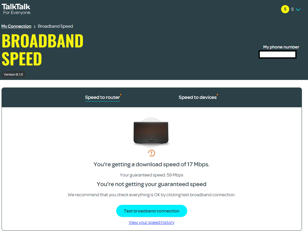

The speed is still 100% fine, achieving 80mbps/20 (exactly what we pay for) - yet talktalk speed test shows otherwise, the issue is with packet loss making it impossible to do any high intensity tasks which relay on packets being delivered in a timely manner such as video calls and gaming.
This is affecting my work and yet noone at talktalk has been any help over the last months fixing this.
The openreach engineer told me it was an issue with talktalk servers.
I have attached packet test from an external source into my ip address.
i have also attached a speed test result over last 7 days from talktalk support page.

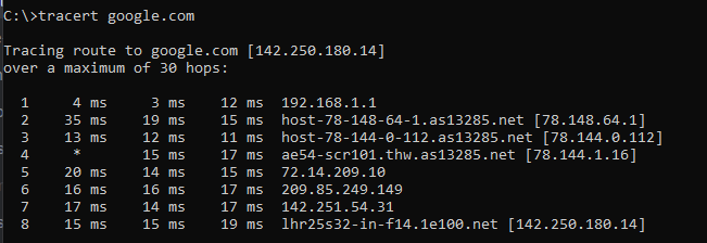

i have attached a traceroute.
i have attached current speed test (this is not true i am receiving 80mbps...)

My friend tested on FTTP 1gbps and also got 100% loss at the same point on google side, but he got 0% loss on all other sections (im losing 3/4/5% on talktalk hops).
i think if you test the same you will see 100% loss on the same point at googles end

Hi @Ssmith46 there seems to be a problem along the network at 172.253.66.101 where you get 100% packet loss.
This needs to be referred to TalkTalk's network dept. I wili ask them to do this for you.
