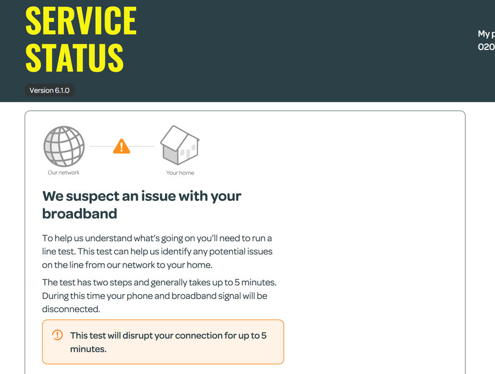

Having accessed your support page, the speed test confirmed the slower speed to my router (see Picture) and when attempting to run a connection test, a fault was picked up, but a line test weirdly found no issues at all. The reference number to this fault is REP-12959300.

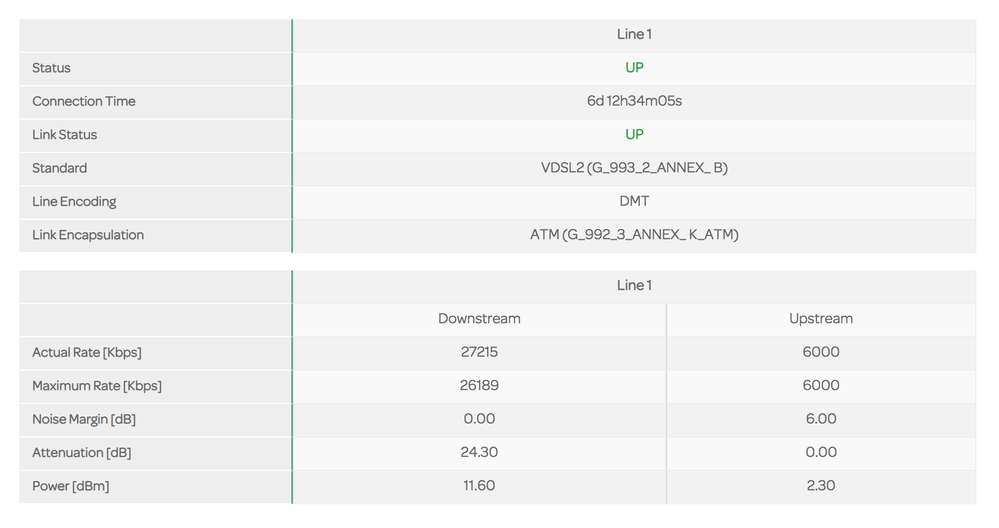

I’ve also accessed my router panel and I’ve noticed changes on my xDSL stats. These include my maximum downstream reducing from about 47500kbps to 28563kbps as well as having zero noise margin on my downstream. Also weirdly, my actual downstream rate seems to be higher than my maximum rate. Is this even possible? I’ve attached a picture of this for you to see.

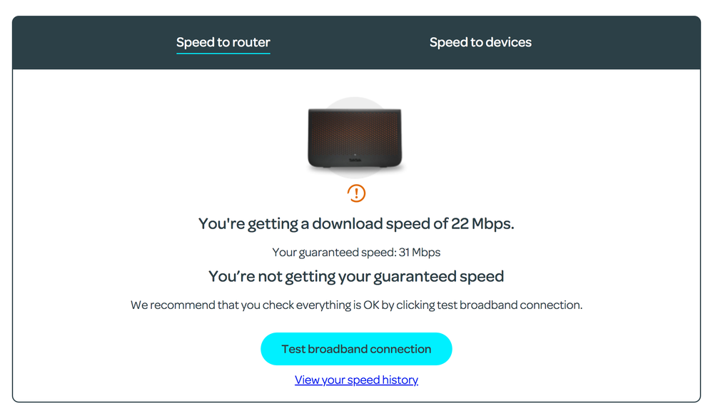

The engineer came on Friday Afternoon and carried out works. Once he was done, he told me everything was reset and to give it a couple of days for my speed to return back to normal. He also told me to contact my ISP again if it fails to do so. Unfortunately, not only has the issue not been resolved, but i'm now getting even slower speed at 22mbps. It's Declining by the week.
Speed to Router 28/06/23
Connection Test Pop-up 28/06/23

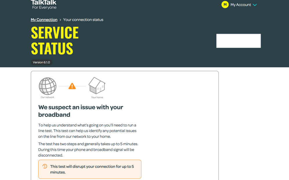

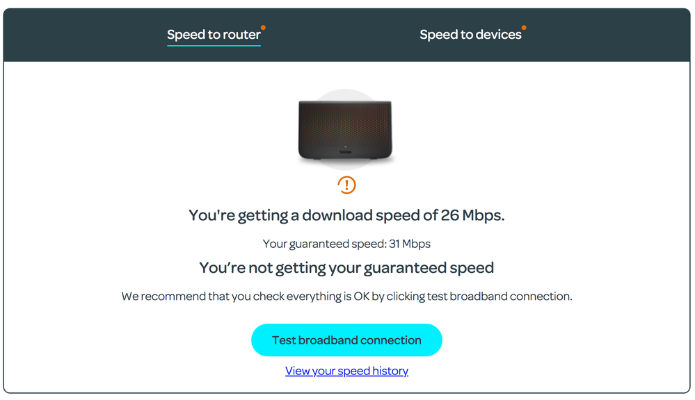

My replacement router has now been online for a week, but my speed has worsened than when I initially made this post two weeks ago. Your speed test via the support page and DSL stats shows the speed to my router is only about 26-27 mbps. Also when attempting to run a connection test, I always get a pop-up of a potential issue with my line. Can this be looked at as soon as possible please.Run A Connection Test Pop-Up
Speed Test

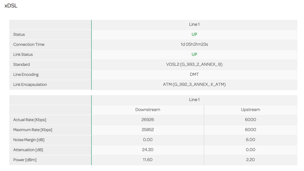

The router arrived yesterday and has now been online for over a day. The speed has worsened, but is probably due to the internet being disconnected due to troubleshooting attempts along with replacing the router yesterday. How long will it take for the internet to stabilise? I've attached DSL details below.DSL STATS
